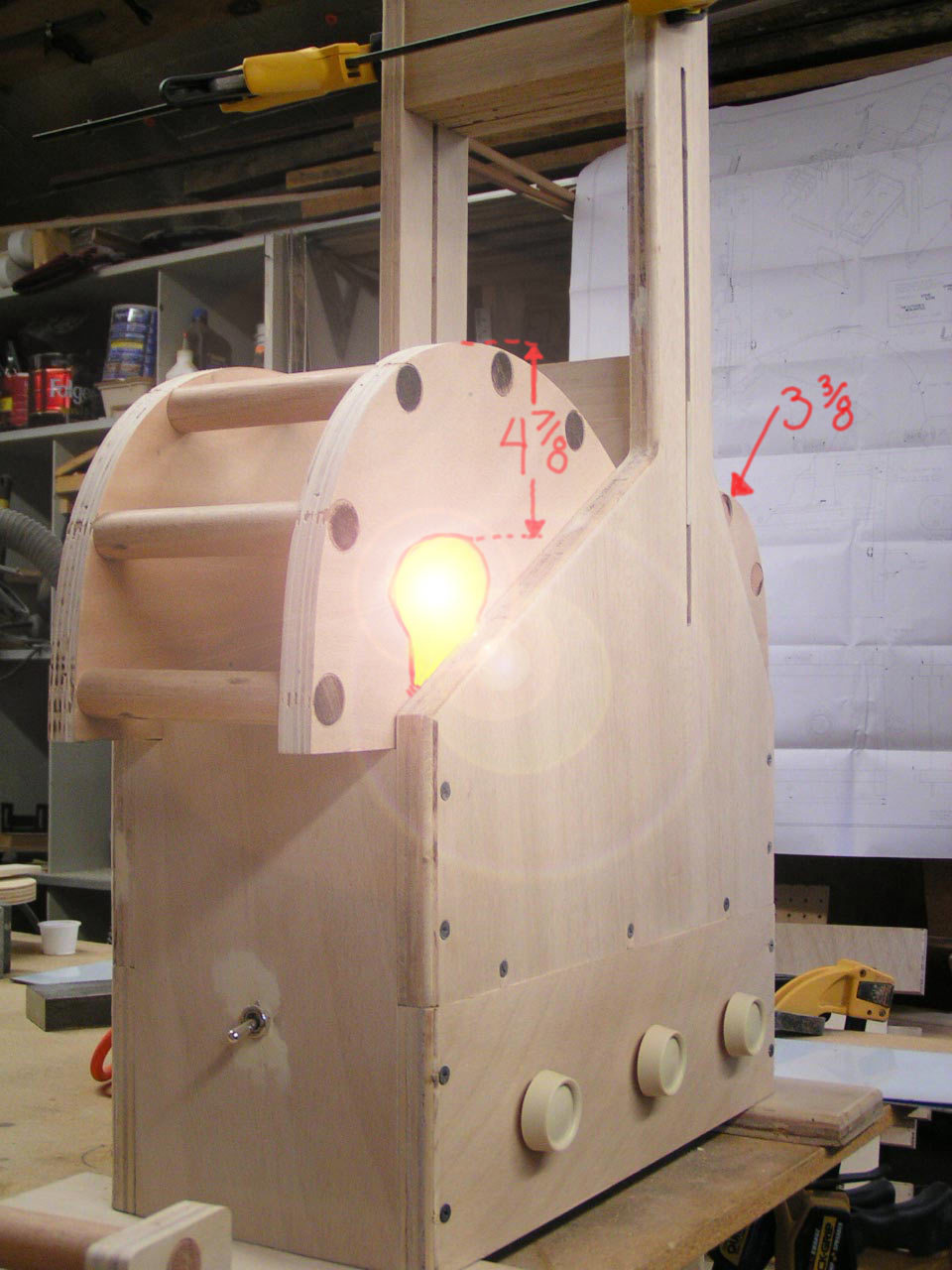

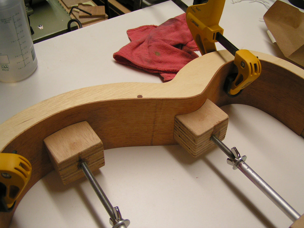

PostPosted: Sat Jun 03, 2006 2:22 pm
Posts: 61
Hey Mike , just to reply to my follow up question, the sides bent perfect as a matter a fact i took a measurement from the top of the bulbs to the top of my form (at lower .... height 4-7/8) (the upper 3-3/8) the temp rose farely fast. as soon as it reached bending temp .......it was on like a pot of neck bones. . . the sides came out looking good
the side in mold
thanks Mike for the comment.
